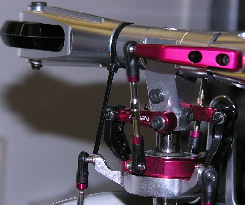

Hi all, latest update in the saga............... long story short. During my maiden hover, I noticed a tendency for the tail to drop (rear swash tilt). This was my target for resolution when my landing gear broke :duh:
I made some enquiries with B.D. and checked over the info drop-downs in the software to find out why it could be doing this. Xmas and New Year holidays at B.D. delayed their response, however, I came up with some info from the software that sounded like "tune the gyro DURING the test hover". The only way I can think of to do this is via the trimming buttons on the Tx., a big NO-NO! It turns out that it's necessary to go through the setup process once again, so in this case, not during the hover.
The sequence of photos and screen shots below show what I discovered and what was done to correct the situation.
Aileron Servos Before 01_Swash B4.JPG 02_Swash B4.JPG Elevator Servo Before
Aileron Servos After 03_Swash After.JPG 04_Swash After.JPG Elevator Servo After

Looks good Phil. As you say, trims on the Tx is a big no-no on any flybarless heli. I disable trims on all my heli setups.
The swash looked a fair bit out, was it checked for level during the build? I'm often too lazy to remove the head to fit a swash leveler, so I use the 'ghetto' zip-tie method:
It's just as accurate.

Yes, the swash was perfectly level prior to the first hover. That's one of the things that surprised me most. I'll dig out the B.D. wording later today.
Presumably you spin the rotor around to check each swash 'horn' individually using the cable tie system as pictured. I've heard of it but never seen or used it myself going for the 'locked-in' feel of the correct levelling tool. I'll give it a look-see and maybe your "lazy" way will feature for me at some point. It would definitely have given me an opportunity to see what had changed whilst at the field but not the ability to do anything about it until I got back to my laptop.
Bye for now.
Smoggie
Yes, you just turn the head and check the lugs on the swash individually. If nothing else it's a quick way to do a course check if you suspect a problem and dont want to go to the trouble of removing the head. In fact I think it's probably just as accurate as a 'proper' swash leveller, possibly more so because the levellers do have a little play on the shaft which allows them to tilt ever so slightly.
The 'proper' leveller is easier if you also want to check the swash at the top and bottom of the collective travel range (which is good practice).
