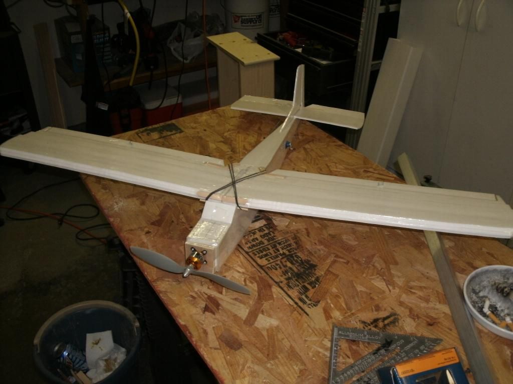

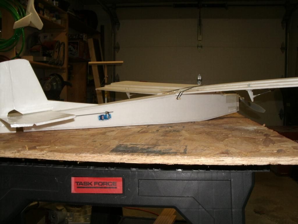

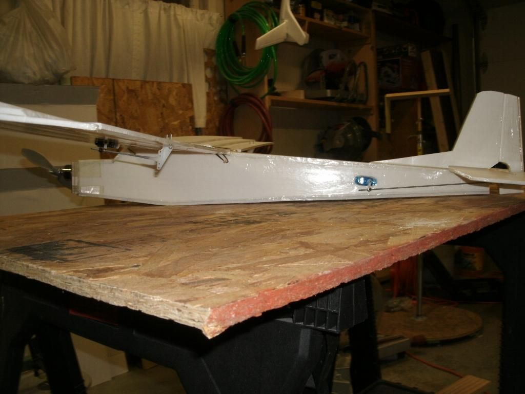

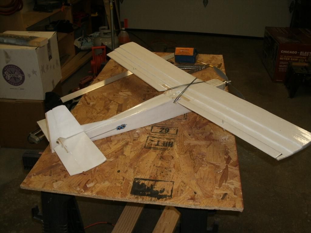

The only thing I got wrong on this one was putting the inrunner on it. I tried to keep the motor contained within the cowel, but left very little gripping erea for the spinner.
Since then I have modified the motor mount to an external position.
Only other modifications have been putting an extended tab with Birch Ply to the rear of the top wing for more support tucking it in to the fuse.
Besides that, my battery is right up against the firewall and the ESC and Receiver are mounted on the inside right side of the fuse just below the wing.
I have pretty close COG to your theoretical on the print out.
Love this one.
- - - Updated - - -
Oh, and some plastic laminated skids for the underbelly and at the tail.
