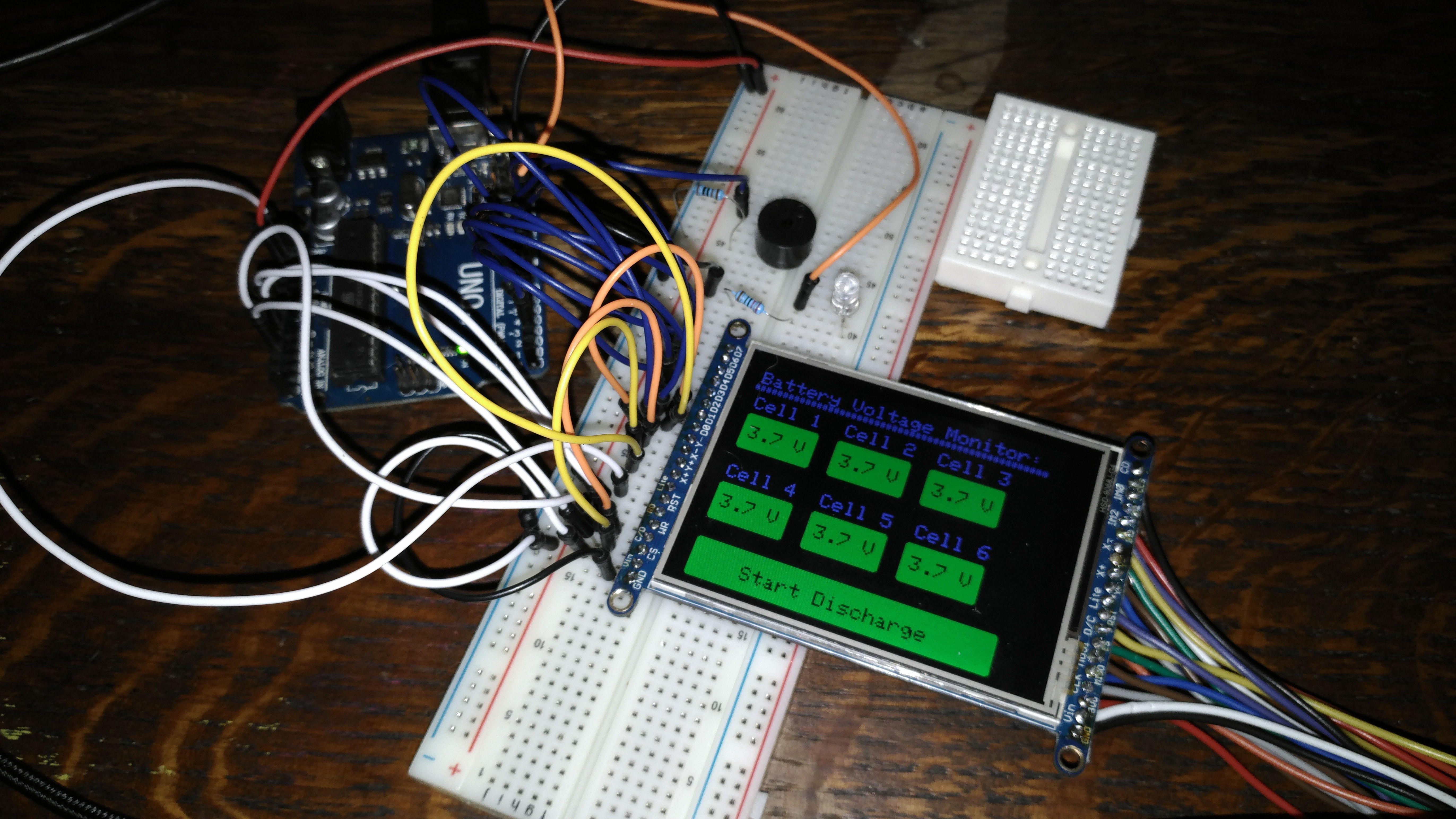

This is the current welcome or home screen:

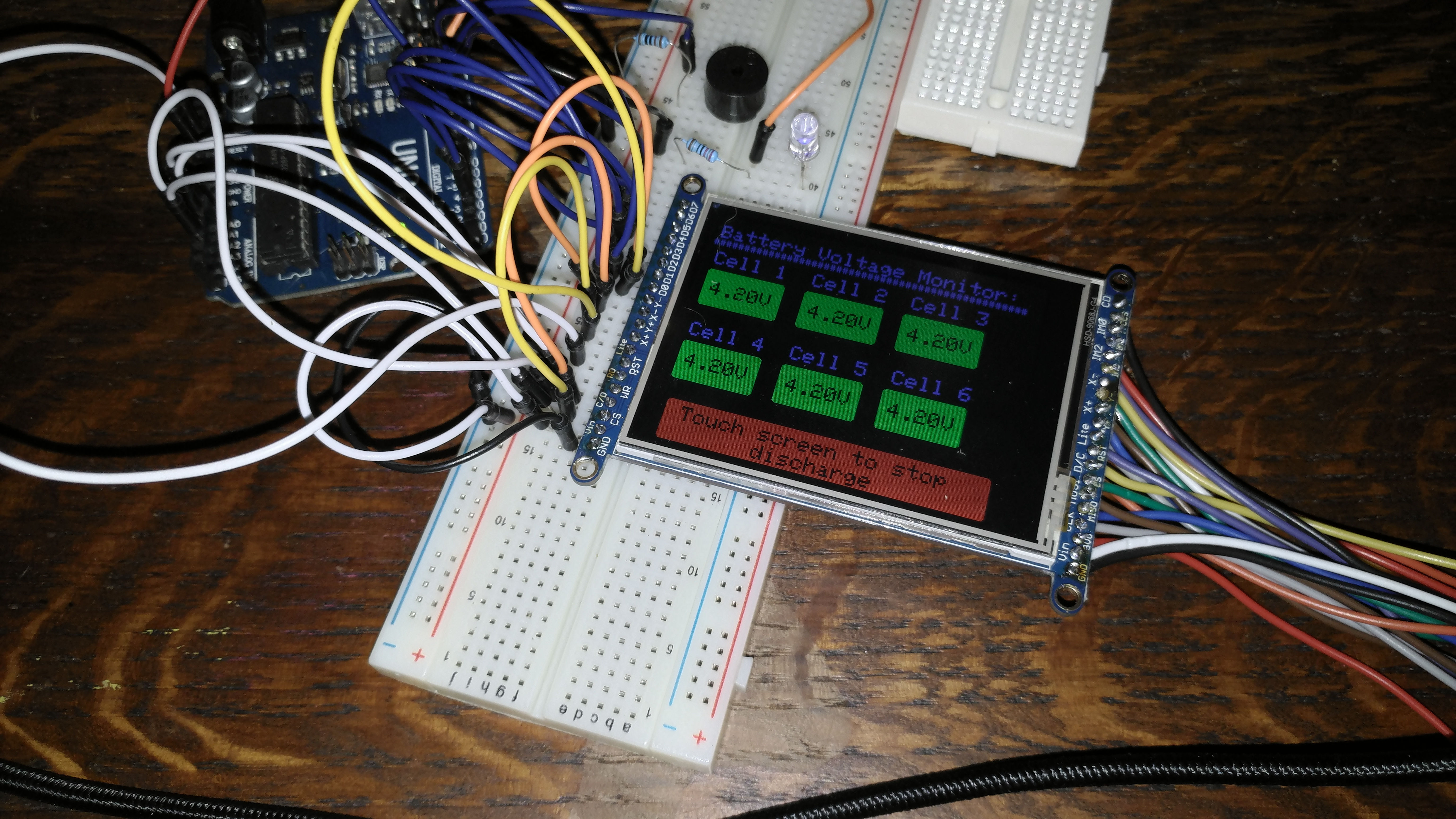

As the pack discharges this screen will show the voltages:View attachment 20697

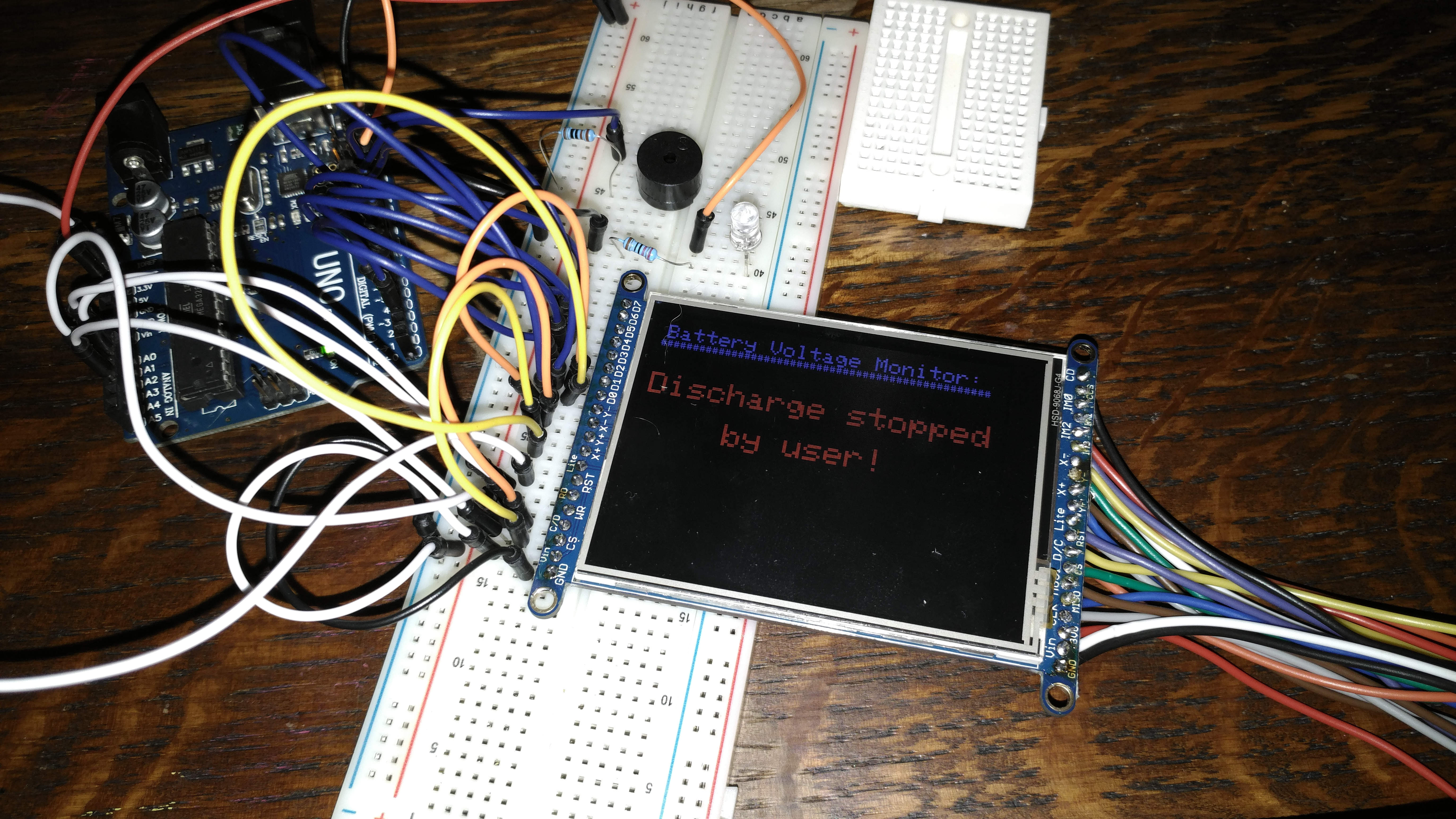

When the discharge is stopped this is the final screen. It stays for 5 seconds and returns to the home screen.View attachment 20698
