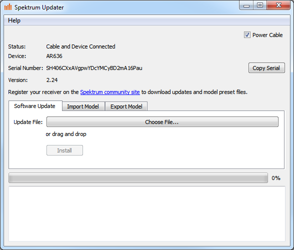

    I have a USB interface : AS3X programmer- SPMA3065. It says to plug the USB port to the computer and the other end to the data port on the 8010. Nothing on the 8010 is marked data port. Can something tell me which one is the data port? Thanks.

    To update a receiver using the Spektrum Updater, follow the instructions below:
    1. Download Spektrum Updater v1.1 and install it.
    2. Open Spektrum Updater from the Start Menu or Desktop.
    3. Plug the USB programmer cable (SPMA3065) into the computer and plug the cable into the BIND/PROG port of the receiver.
    4. The serial number of the receiver should be displayed.
    5. Register the receiver on the Spektrum community site.
    6. On the community site, click “Download Updates” next to the receiver that you want to update.
    7. Click “Updates” under the update to download it.
    8. In Spektrum Updater, either click “Choose File…” and choose the downloaded file or drag and drop the downloaded file to the window.
    9. Click “Install.”
    [​IMG]

    Thank you very much, that worked very good. I was trying to use the wrong program, but I though it was the one that Spektrum told me to download. It was Spektrum programmer. Thanks again. It still didn't show my device and it wont let you click in and add it.
