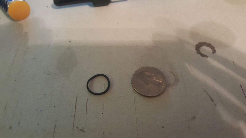

this little o-ring came out of the swash. I can see where it is supposed to go, inside the swash around the half circle ball the main shaft goes through.. How important is this? is there a way to take that swash apart? Do I have to replace the swash?

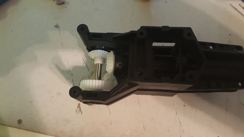

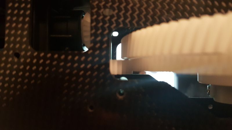

the tail gears. as you can see the tail gear is not lining up with the auto-rotation gear. The main shaft is locked down with no play in it. the tail gear seems to be pressed on to the shaft with no way to adjust the gear up or down. This does not seem right to me. The spacers are installed and there is no way to adjust the main shaft either. it has 0 up and down play in it.
- - - Updated - - -
It looks like you are missing a spacer between the main and auto gear. But, if everything is spinning free, you should be fine. As for the O-Ring, as long as you keep an eye on the swash, keep it clean and oiled, you should be fine. Just drop a drop or two of oil in there before every run, or at least every 5 runs and it should last quite a while.
OK.. I can add a spacer.. guess I did not think of that.. as far as the oring.. are you basically saying dont worry about trying to put it back in? just drop some oil into the top of the swash every now and then? what kind of oil would you suggest?
I have never seen a swash with an O-Ring, all of mine are just open bearings. But yeah, just add some oil and you should be fine. As for what kind of oil, I use Team Trinity Bearing Oil. But you can use something like 3M oil if that is all you have.
i took the main gear apart and the spacer was installed. The manual only calls for one spacer and it seems to me that if I put another one in there the hole the bolt passes through to lock down the main gear will not line up. so perhaps as you suggested, I am going to leave it alone because everything is turning smoothly. just annoys me a bit because those gears should line up perfectly IMHO.
In that picture, it looked like the tail gear was really close to the main gear, so I wouldn't suggest trying to raise that up. That could throw off the tail gear mesh as well.
HI Bill the O ring is a dust seal for the swash , just keep an eye on it and keep it clean and lub it , if you start to get play then replace the swash , as Tony said there is a spacer between the auto gear and main gear , there is also a spacer that sits on top of the upper head bearing block so this will lift the main shaft and remove any up and down play check this is fitted as well , this fits between the collar on the main shaft and the top of the top bearing so fit the spacer then drop in the main shaft , hope this reads ok so you understand it
Thanks Neil.. you explained it perfectly and actually I used both spacers for the main shaft and the spacer between the main and auto rotation gear is there. There is no up and down play in the shaft either . I pulled the tail boom case apart too and it is put together right. It just seems to me the tail gear is not pressed onto the shaft as far up as it should be.
Hi Bill just checked my 500s and the tail drive gear is level with the top edge of the auto rotation gear ,so you may be right about its not on the shaft right
