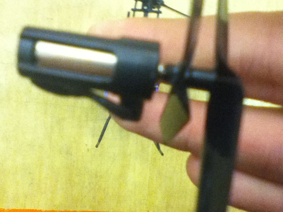

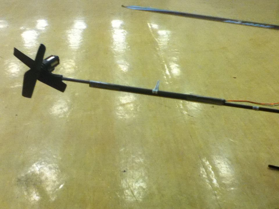

All I had were 2 other burned out mCP X tails, and a brand new Nano CPX tail assembly. So, I cut the mCP X system off the boom, leaving just the carbon tube. I put it into the frame... I then took the Nano CPX tail boom, plugged it in, the proceeded to TAPE it to the one on the frame. Made sure it was solid and square... it works. And voila! A working absolutely ugly tail boom!

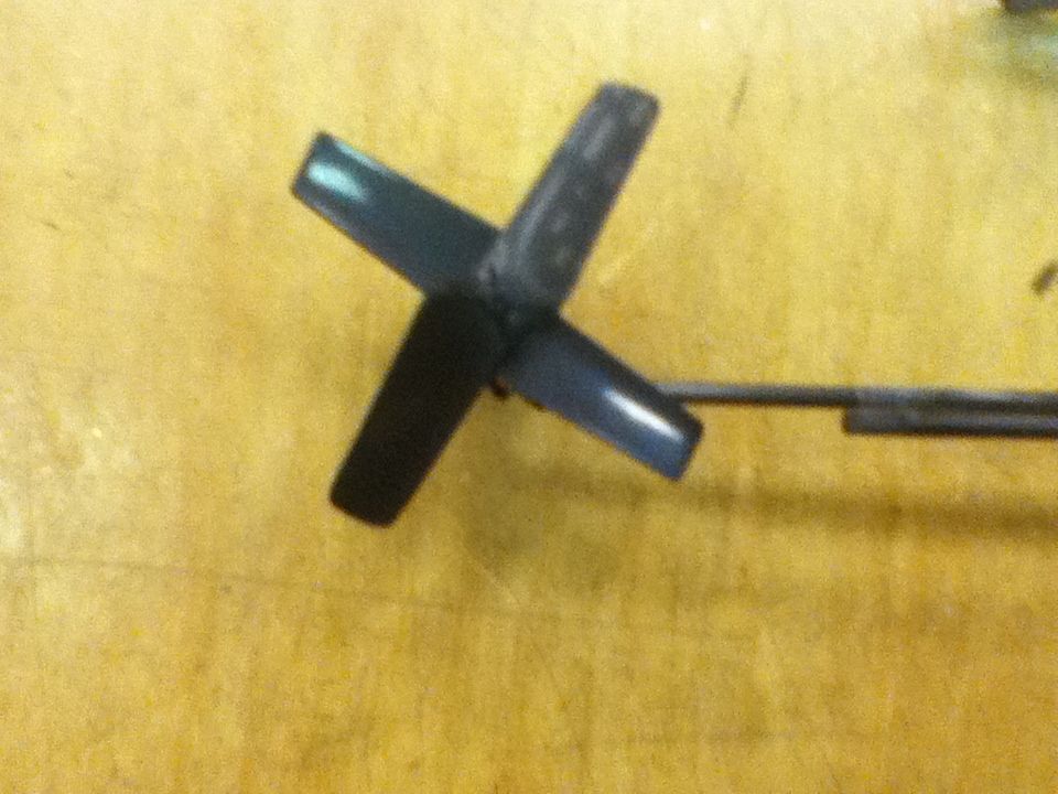

The tail held okay (still blew out) so I decided to do something else. A buddy of mine showed me his tail... 4 bladed tail rotor... kind of. Just two stockers next to each other. You have to cut off the back of one of them in order to get both on.
I put the one I cut on the inside, that way the one that had more gripping the motor shaft held it on better.

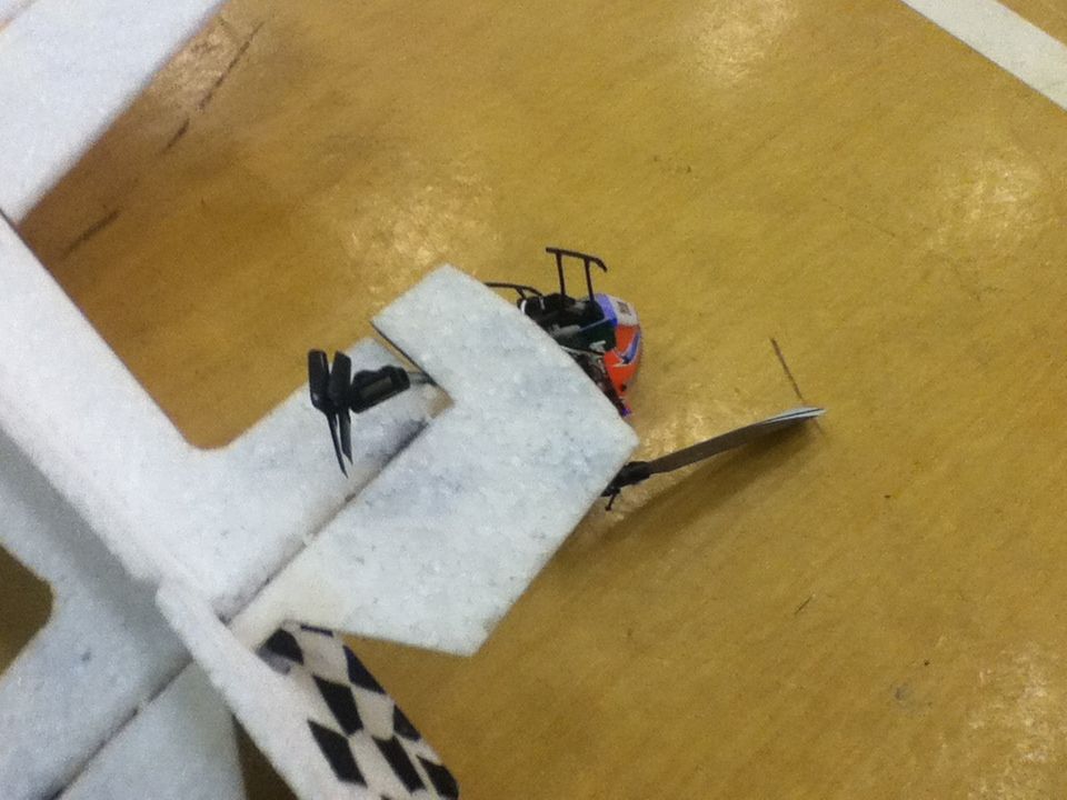

I also had a funny collision with a plank

It still blows out some, but it's better than it was before
