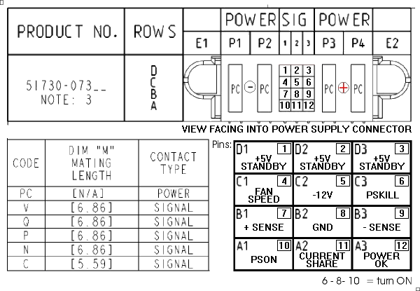

I'm in the process of obtaining the parts to create my own parallel DPS600PB supply (this is actually for supplying power while programming BMW/Mini cars.
I know how to wire it all together, and have no issues with that, but I did have a query that doesn't seem to be answered anywhere - or even discussed...
I'm going to connect a rheostat/potentiometer between pins 7 and 9 to control the output voltage and bring it up over 13v. I'm going to be aiming for 13.6vdv, but realise this is close to the OVP cut-off.
My question is with regards to measuring the output voltage.
I will be wiring in an LCD voltmeter display. Now while I could hard wire it to the 12v output terminal, I'd rather not. I plan on connecting to these terminals with 12-10awg spade terminals.
With that in mind, and being told that pins 7 and 9 are tied to the 12v rail, does anyone know if the output on pin 7 would match that of the +12v connection?
If yes, would wiring a voltmeter between pin 7 and 8 (GND) affect the operation of the rheostat connected between pins 7 and 9 ???
