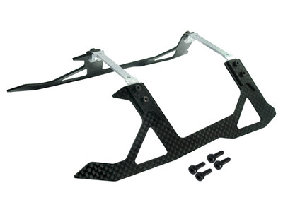

I got my new skids in and installed. I went back to menu G and leveled the blades. they are at 0. I went into menu K and that's where I'm at right now. Trying to figure out how to set that up properly.
