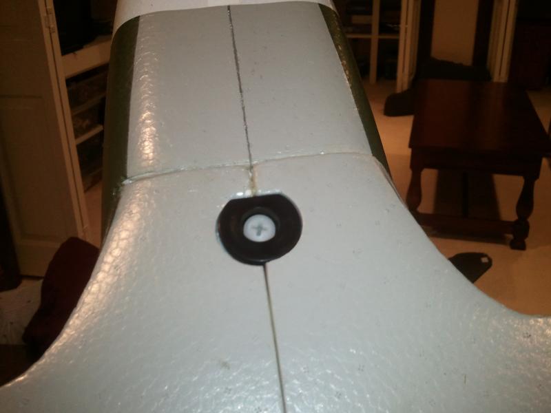

All the servos and the motors are preinstalled for you. The first step to assembly is glueing the 2 wing halves together. Dont use the recomended glue, because it isnt strong enough, and they dont provide enough of it. For the wing, i used Gorilla Glue Epoxy. Anyway, when you have smeared glue all around the wing half, stick them together and make sure they are lined up right. To keep them in line, use the little black peice of plastic that is used to screw in the wing. View attachment 935 A little bit off low tack tape wouldnt hurt either. While the epoxy is drying, i decided to put the elevator on. Before you put it on, you have the choise to make the tail wheel stearable. I was going to do it, but the tail wheel's plastic is incredible strongand i couldnt drill through it. Alls you have to do to assemble the elevator is drop it into the slotted place and glue it. I used hot glue bacause it dries quickly. After that, you need to glue in the vertical stab. All you do is slip it into a 'lil slot. Be sure to put the rudder pushrod guide into a precut slot. View attachment 936 Next you have to go in your bag 'o' asseceries and dig out 2 ez adjusters, and 1 control horn. Just simply glue the control hor to the rudder and install the ez adjuster. The elevator horn is installed. All you have to do is install the EZ adjuster. View attachment 937 BTW, make sure you use threadlockr on all the screws.

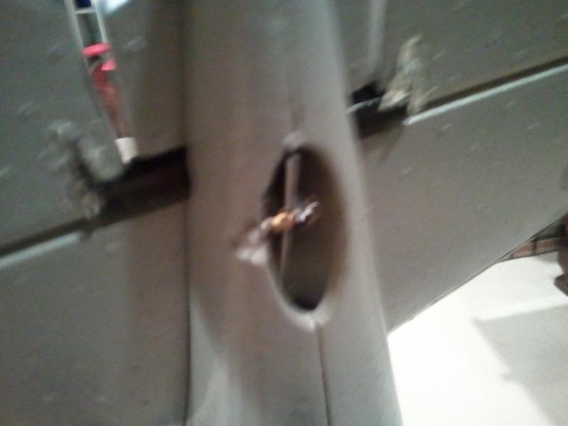

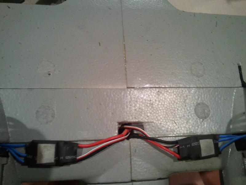

Now on to installing the ESC's. Nitroplanes claims that it comes with 2 40A ESC's , but mine came with 2 30A. All yu have to is plug in the wires, and stuff the ESC into the ESC compartment. Also, you want to thread the esc wires and aileron servo wires through the provided hole. Once, all that is complete, glue on the Wing cover that hides the wires. View attachment 938 I recomend taping it on incase you want to access it again. NOW, you can glue the landing gear supports on.Now just install the 3 blade props.

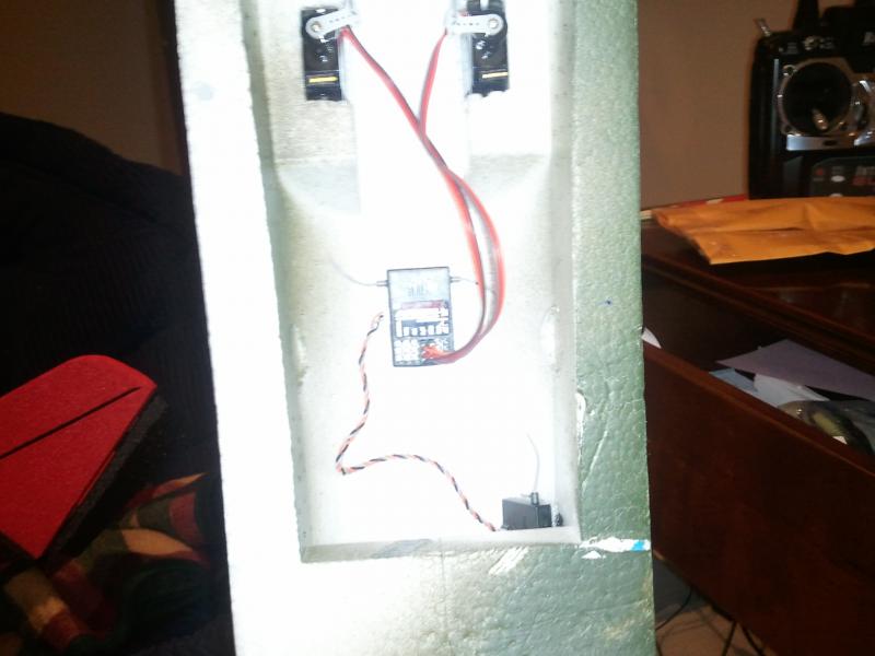

In this kit, you have to provide a reciever. I personally useda AR6210 DSMX Spektrum Reciever. Here is the best, and most convienent way to mount the rx: View attachment 939 Plug the ailerons and throttle into your receiver. Make sure to slide the ESC battery wires into the nose of the plane. Then just screw on the wing with the nylon bolt.

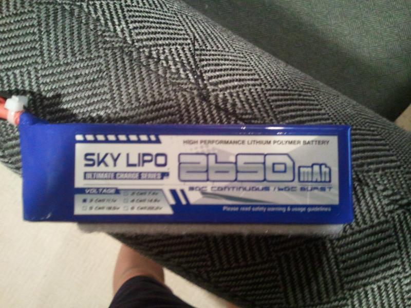

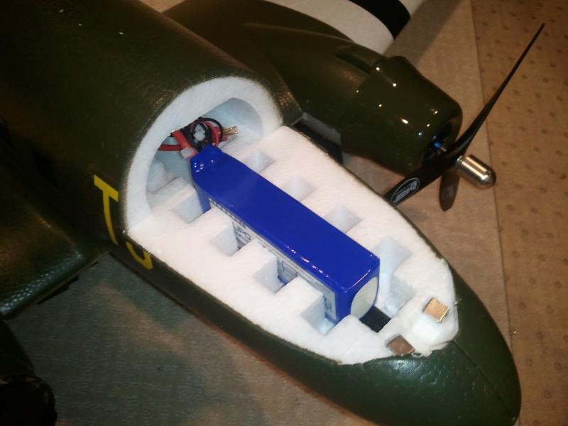

So open up the canopy hatch and put in the battery. Dynam recomends a 2200mah 3s 15c. I used a SkyLipo 3s 2650mah 30c pack. View attachment 940 If you use the bigger one, put it 1/2 inch from the front off the battery compartment. View attachment 941 A 2200 will go all the way in the front.

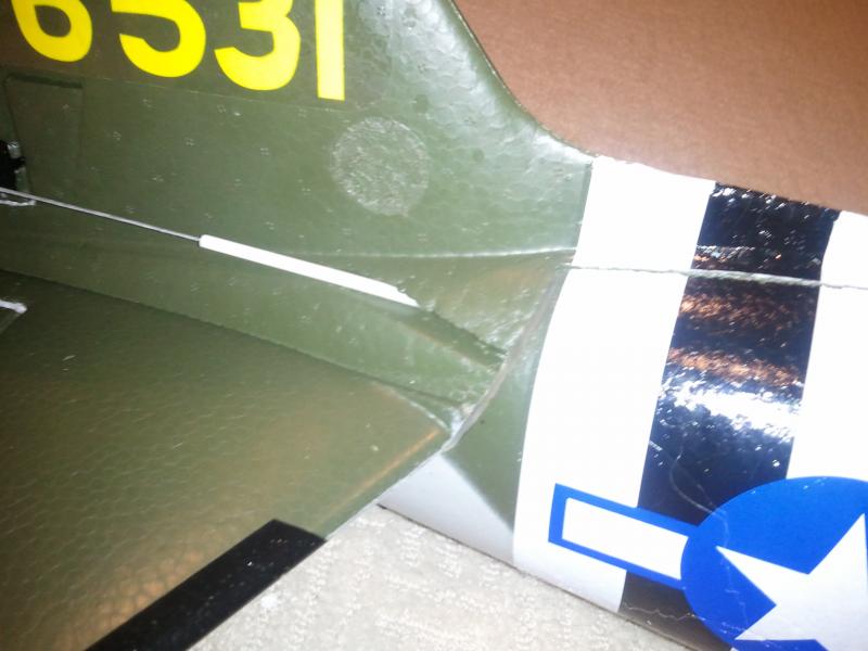

3. My elevator was slightly warped.

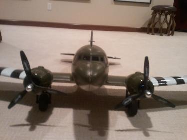

Overall, i would recomend it to a friend. It is awesome seeing this flying through the air, escorted by a fighter at the field!
