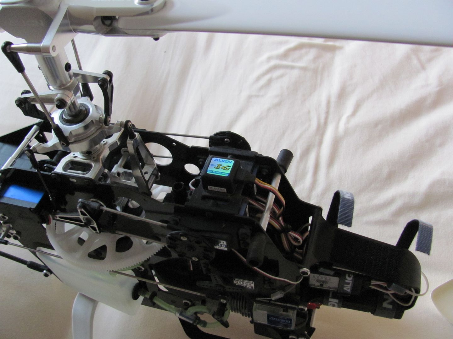

Picked up this pro built but never started 600n today, been in the guys loft for ages!

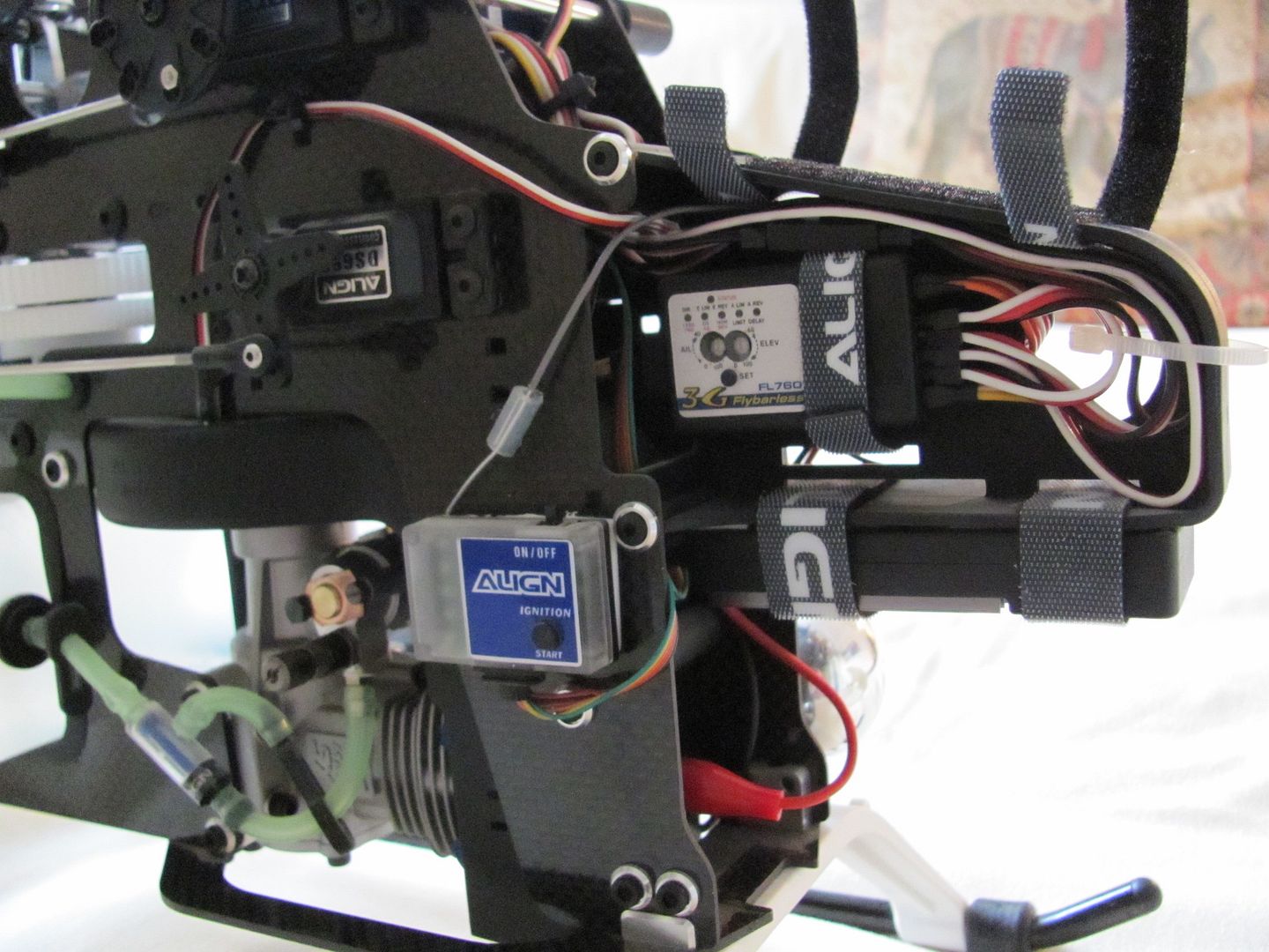

Question is, it's an older modle and has the out of date 3G unit, should I just use it as is or fit a DFC head and new 3GX?
Also it came set up with a Futarba Tranny and I want to use my Spekky DX7
Don't change the head, as those heads are pretty robust and the links give way before servos in the event of a crash, I would probably go for a better gyro though, not a 3gx as they hate vibes, use the money you can save from not changing the head and buy an Ikon/Brain, fast lad in this weekends sale have them for £144 delivered
What Kev said, lol.
You can still get spares for that head and now after the hype of the DFC head has died down a lot of companies are going back to that style, it leaves more room for a variety of headspeeds. DFC tends to favour higher headspeed.
I havent flown the original 3G but it is an early fbl unit and by all accounts was pretty poor.
With the servos, engine, airframe and head you have a very good base to add a good fbl unit like the Brain.

I still have my AR7200BX sitting here if that interests you. £85 and its yours. Will work perfectly with your DX7 too.
Sweet find. And good deal on teh Ikon. I was hoping that you were not going to get a 3GX. I have tried to find the solution for them, and now that Align is pretty much axing the 3GX and telling everyone to purchase a new gyro or get bent, I'm done with them. The 3GX that is. Still love the birds lol. Really need to get mine out and fly them again. Keep us posted.
