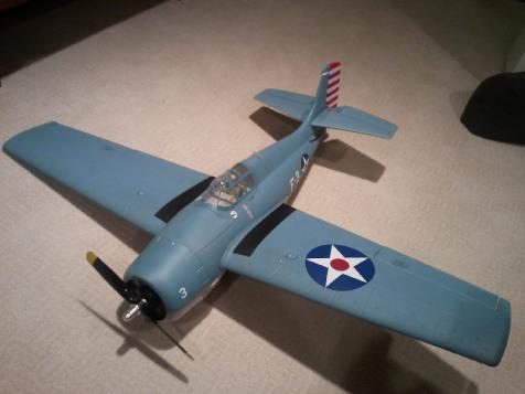

Parkzone F4f Wildcat Bnf
Parkzone F4F Wildcat BNF​
Bought from HorizonRC.com($180)
Specifications
Wingspan: 38.4in (975mm)
Length: 28.7in (730mm)
Weight: 25.4oz (720g)
Motor Size: 480 sized 960KV outrunner brushless
Receiver: AR600 DSM2 Spektrum RX
Servos: Parkzone SV80 x4
Prop: 9x6
ESC: Parkzone 18A Brushless
Battery: 1300mah 3s 15c

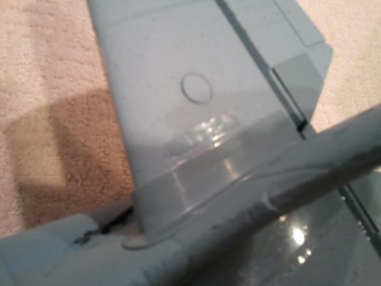

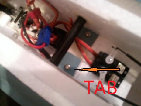

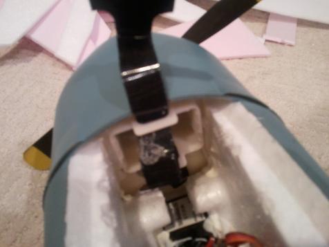

The first thing that i did was slide each half of the elevator slot into its predesignated area. Once you've done that, use the provided tape and tape on the elevator. View attachment 975 That is the hardest part of the assembly! Now the only thing left that you have to do is put in the wing halves. All you do is take the carbon fibre spar and slip it in one of the wing halves. While slipping in the wing half, be sure to thread the aileron servo wire through the provided hole. At this point you should have one wing in and a carbon fibre rod sticking out the other end. Open up the canopy and you'll see a blue tab attached to the main wing. View attachment 976 Go ahead and screw it in. The screws are found in the bag 'o' accesseries. now do the same with the othr wing half. Slide it through the carbon tube and screw it in. The screws for some reson are SUPER hard to screw in! So be aware that you may strip the screw. The last step to build is simply just plugging the aileron servos into the Y-harness that is already plugged into the RX. Go ahead and insert your battery into the battery compoartmend and use the provided velcro strap to secure it. View attachment 977
