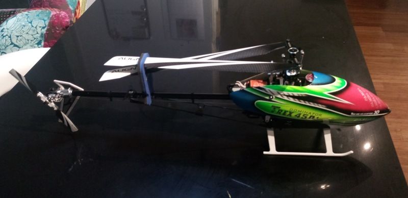

    Hi D.O.G. It came complete with the Align 460MX (1800KV) motor the 6S ESC, DS450 x 3, & DS455 tail servo the only things missing from the Super Combo Kit were the broken parts and the BeastX and battery holder.
    Worked on it most of today and it is getting close, still need the batteries and battery holder may get it in the air this weekend weather permitting (which is doubtful).

    She looks like new, nice work. It must be all the more satisfying to turn someone's pile of dismantled bits that they have obviously given up on, into a beautiful 'like new' heli.

    She looks great mate I bet she will fly well too

    The maiden happened this morning, rain held off long enough to get a couple of flights in.
    A couple of minor hiccups on the way, but nothing major.
    The only issue that it seems to have is dropping the tail, does appear a little bit tail heavy so I may add some weight to the front, I used a 1550 mAh battery that was supposed to help with the tail heaviness of the 450L but hasn't seemed to have worked.

    Well done mate would you it would fly well check the CG of the heli the battery may need to go forward a little if it can
