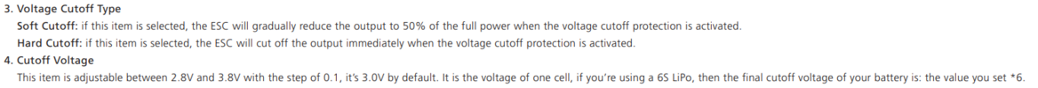

What would cause a momentary loss of power?!. I have grounded my kraken until I figure this out. Attached are two clips that shows the power cutting out, then coming back. I use an ar7210bx, a dx8, and the hw 200amp esc just running straight throttle curves. The first time it happened I just thought I hit throttle hold by accident. Then I put the hat cam on to capture the problem. Thanks for anyones time and help on this.

im just trying to help and please note that im not good with electric heli
but it sounded for me as a soft-cutoff
this is a screen shot from HW 200A esc manual

I really appreciate the response. I narrowed it down to a loose wire coming from my dsmx satellite. I changed it out and it flys like a boss. I fly alone so it's a real pia sometimes to diagnose problems if there's nobody around to help.

Good that you found the problem. I was going to say, it looked like failsafe activating either due to brownout or a receiver 'hold' (lost reception). Having a FBL/receiver that does data logging and RSSI telemetry is invaluable for diagnosing (or avoiding) this type of issue, takes all the guesswork out of it.
