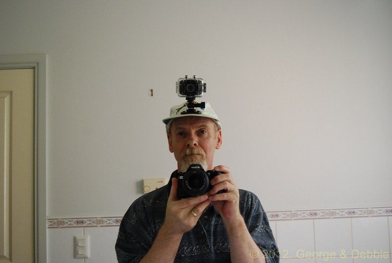

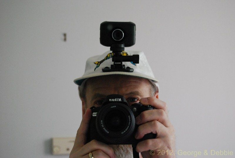

My New HD Sports Camera - Hat Cam Mount
With Waterproof Housing
