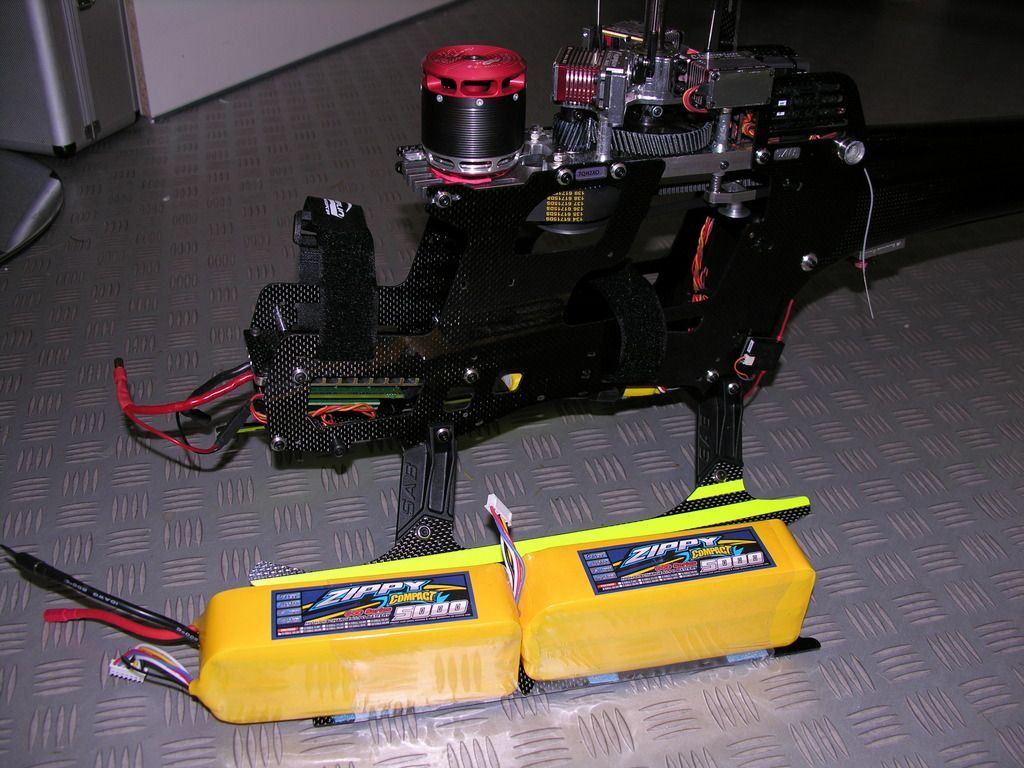

Being a scinflint I decided to use mainly hardware i had laying around or transferred from other helis. This meant no mega 14s power system, I'll use the 12s batteries from my trusty Compass 7HV. The full build spec is:
- Motor: Kontronik Pyro 750 560Kv
- ESC: YGE 160HV
- FBL: Vbar Silverline
- Servos: King Max HV Brushless all round
- Batteries: 2 x Turnigy (or Zippy) 6s 5000mAh 40C
- Rx power: 2s 2200mAh LiPo unregulated.

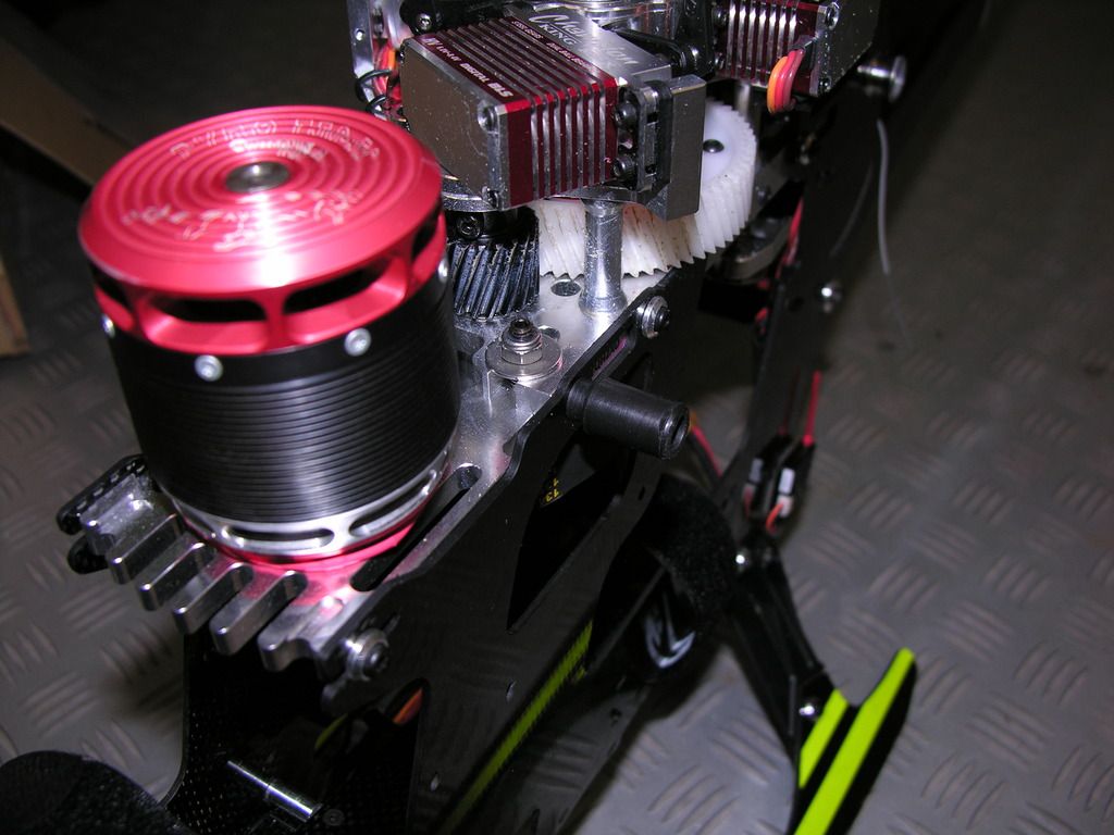

I had to cut the beefy 8mm shaft of the Pyro down to suit the Goblin, it had previously been fitted to a Mikado Logo which use really long shafts. Due to the relatively high Kv I also had to go down to the smallest motor pulley available at 18t. Otherwise it was a very straightforward build, much the same as the Goblin 630 I already own.

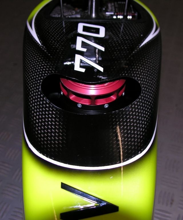

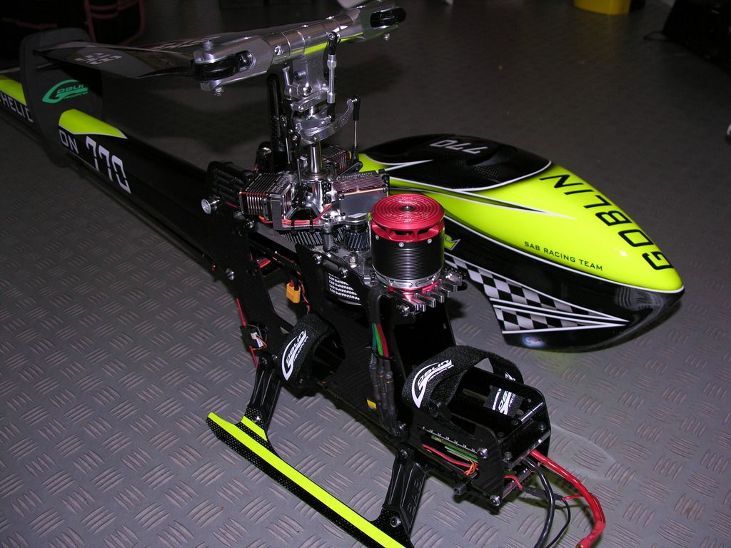

So here are a few pictures:

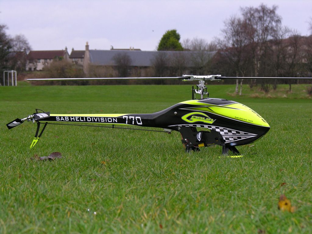

Flying opportunities have been limited by weather but it has flown and was pretty much setup spot on from the first flight. Power is ample, it really only needs 1700RPm to perform well but the motor will turn the rotors at 1950RPM and at that it's ballistic.
Anyway, here is an early flight in very windy conditions:
