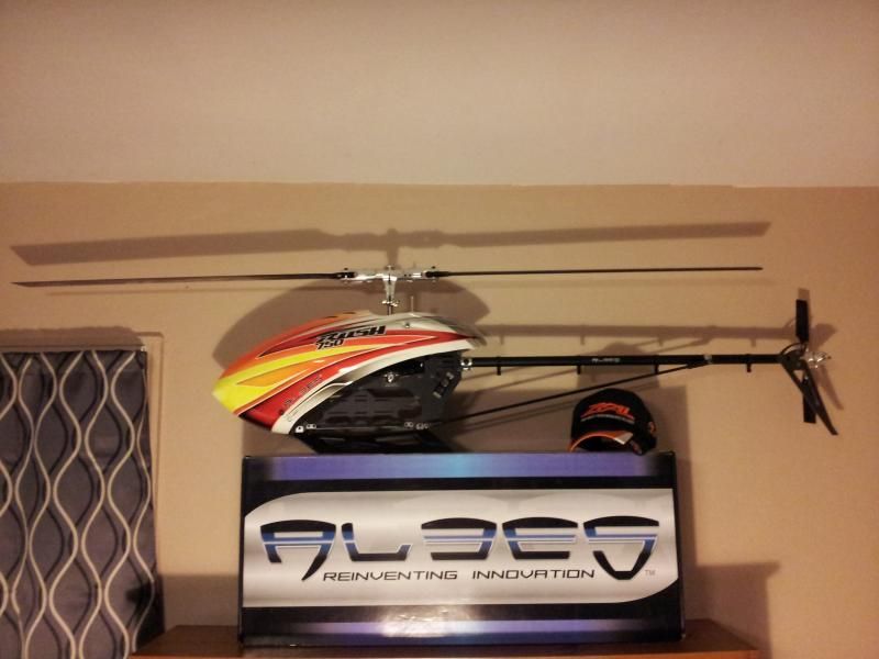

Just wanted to share my latest acquisition. I got lucky on facebook and won a drawing for the new Alees Rush 750 Evolution.
Haven't gotten much air time on it yet as I just began building it in December, and my last flight the tail servo conked out, and nearly trashed her. Luckily I managed to auto down and get it on the skids, but now I am waiting on a new tail servo from AMain.
Stats:
ALEES Rush 750 Evo (in 700 configuration)
Scorpion HKIII-4035-500Kv
YEP 120A HV ESC set in Governor store mode
Promodeler S74140-DLHV Cyclic Servos
Protek 250S Tail servo (on its way from AMain)
KST adjustable Servo arms
HF Mods Aluminum radius arms
CC BEC Pro (May be switching over to an Rx pack with Scorpion Backup guard soon)
Robird G31 FBL unit (Changing over to Spartan VX1N)
Zeal 700mm Main blades (Waiting for the 750mm to come out so I can stretch her)
Zeal 105mm Tail blades (Have a set of 115's already for stretch)
Main gear: 112T Mod1 Helical
Pinion gear: 12T Mod 1 Helical
Tail ratio: 4.75:1
Total length 1185mm (in 700 configuration without canopy)
Flight ready weight: Approx. 11 lbs +/- (My setup)
A cool innovation on the Evo is the Torque dampened drive (TDD) on the autorotation gear hub. Instead of a bolt that runs through the main shaft, the hub has dampeners in it with metal inserts. A metal retainer pin is inserted through the hub and dampers through the main shaft, and two cap screws with washers retain the pin. This allows for much smoother operation of the tail drive system, and reduced wear in hard maneuvers.

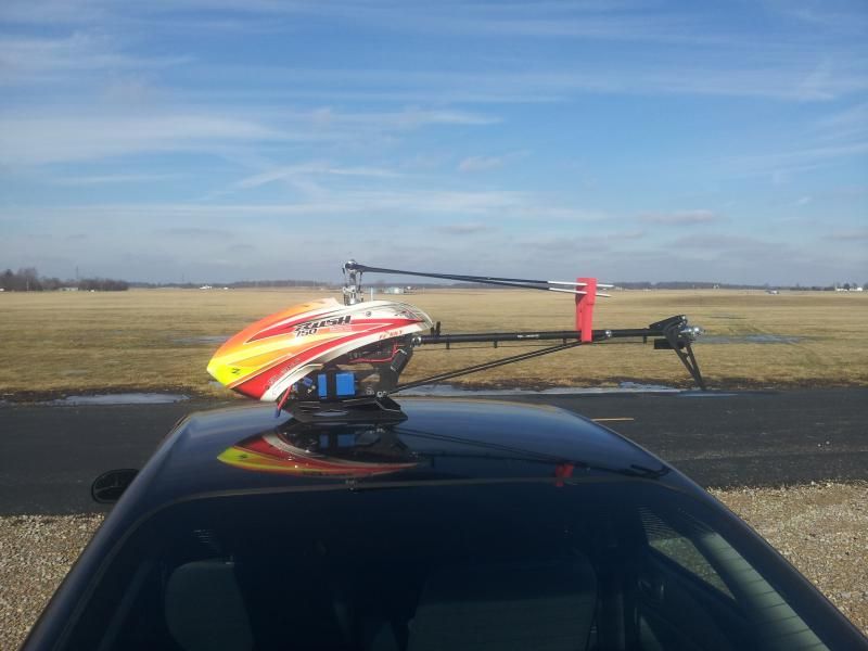

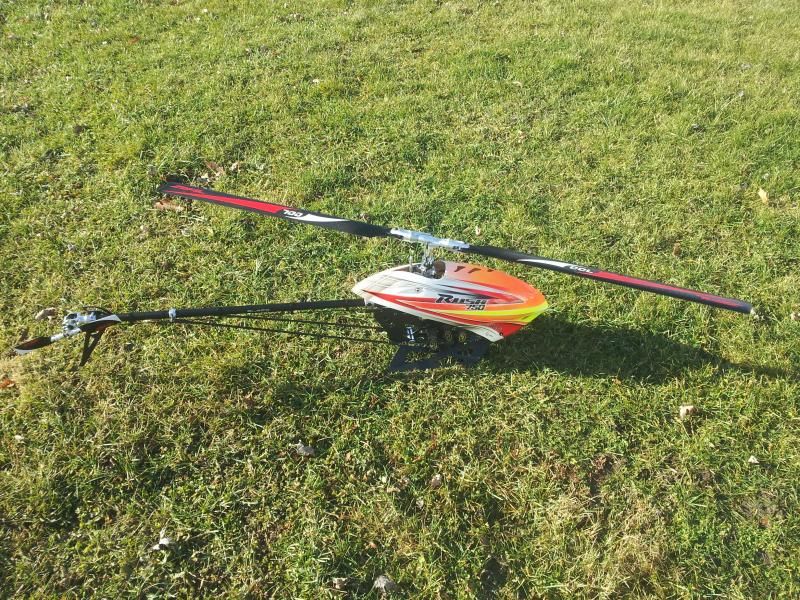

Here's the evo right before some tuning flights out at the AMA HQ field.

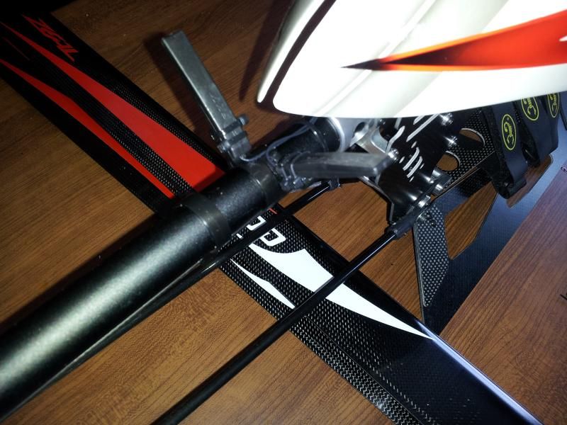

A shot of the HF Mods Metal radius arm upgrade by tony Whiteside. Rockin' Tony's logo on the canopy, as well as some helifreak love.
Rockin' the FrSky Open source baby! My little mod for an Rx PCB antenna mount using stock Rush parts. Two tail rod guides. 3M4011 tape, and a couple of zip ties each. Minimal weight added, and perfect reception.

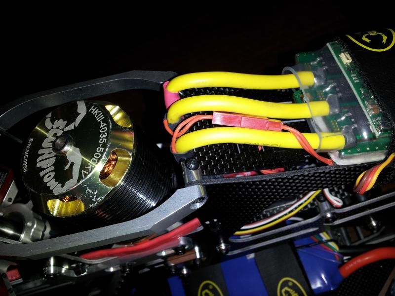

The night before the wiring.
Don't mind the scratches on the motor. It was dinged up in shipping but it spins fine.

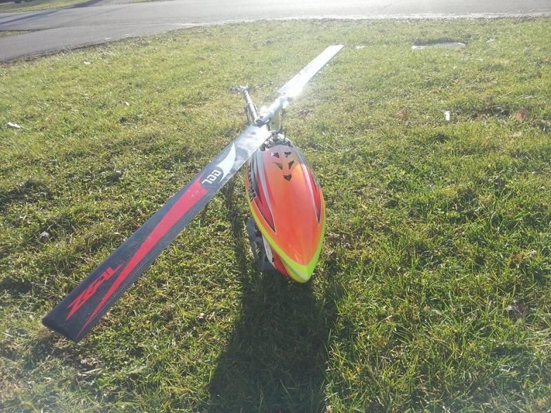

Rockin' some Zeal blades. Nice fit and perfect match.
I named her Leeloo! She's pretty, nimble, and deadly if you get on her bad side!
