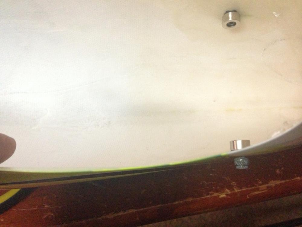

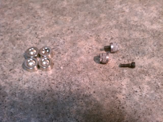

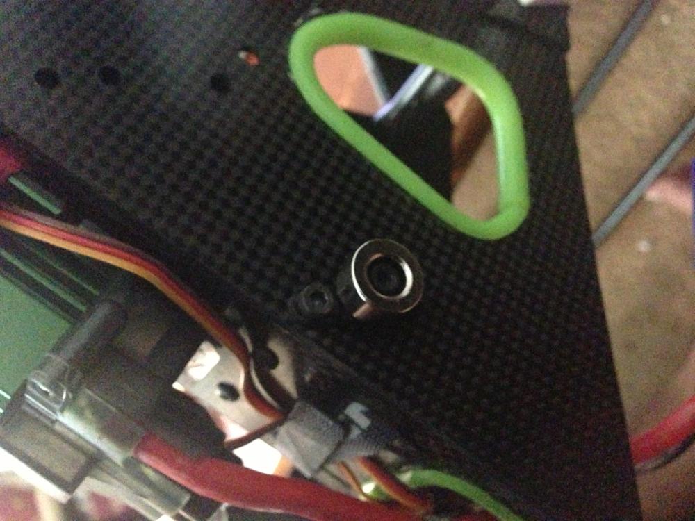

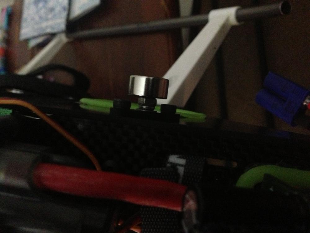

I replaced the canopy standoff on the breakaway mounts with a magnet. As these magnets have a pre drilled counter sunk hole, the magnet was mounted with a simple screw and nut and spaced right for the height using washers/ more nuts on the two sides of the frame...
and my screw in type thumb screws :

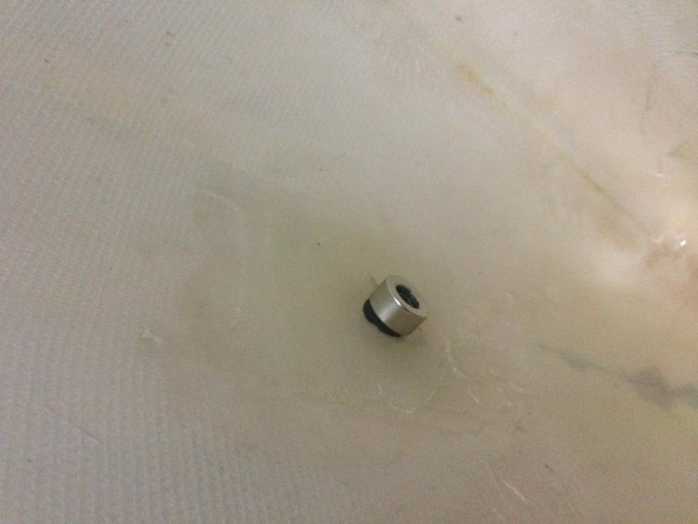

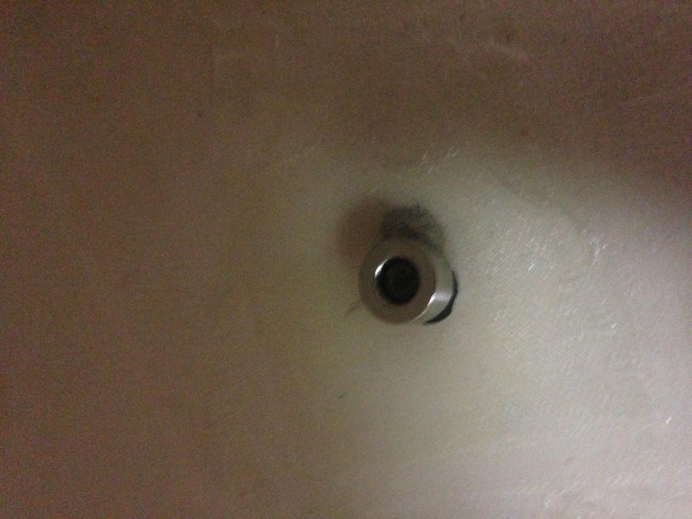

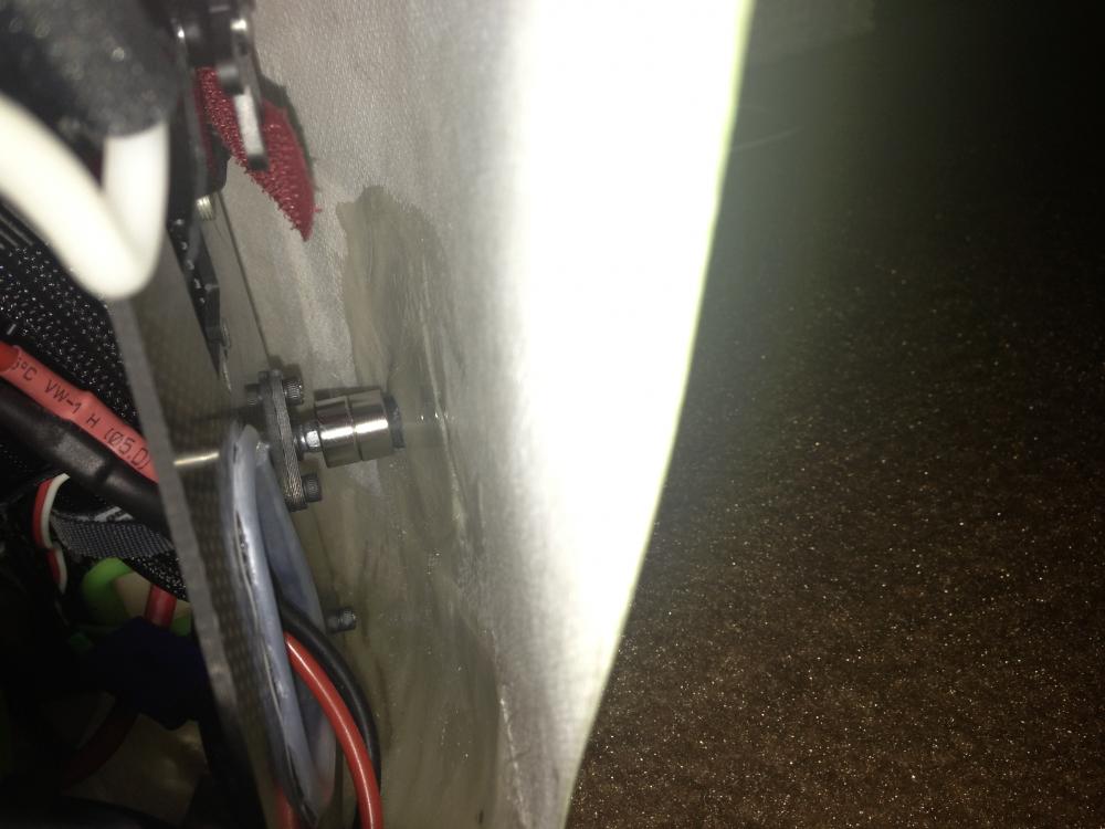

Take the screw out and this time go through the magnet (on the inside of the canopy) through the rubber grommet through to the thumb screw part. Make sure North faces south .. and the magnets come from that company with half magnets drilled from N side, and other half from S side..
here are the pics to may be explain it a bit better:

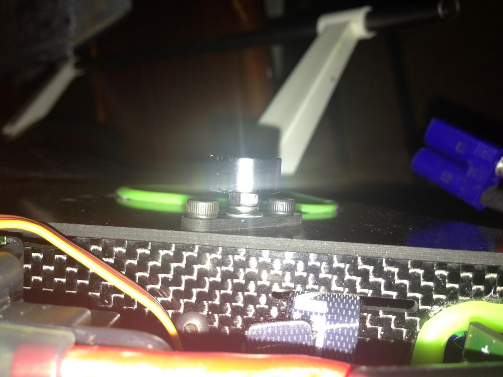

Finally this is what it looks like mounted

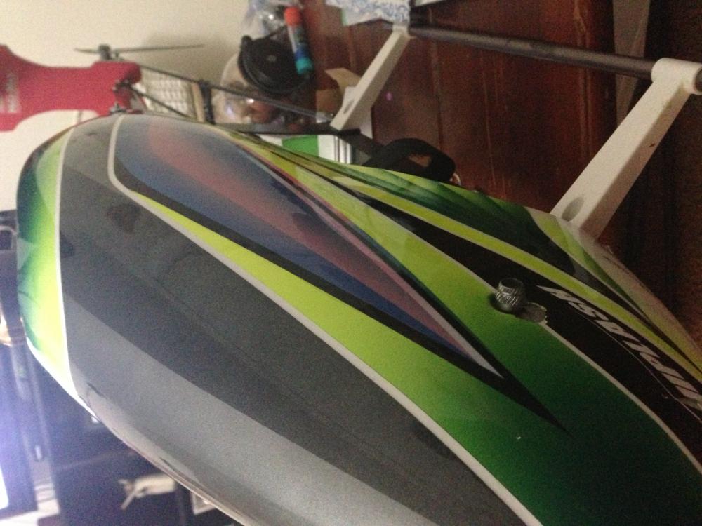

And outside it just looks like I got those thumb screws installed so Stock look.. but I never have to worry about screwing in anything and aligning stuff again!
NOw If you are worried about the magnets letting go ? These are EXTREMELY STRONG magnets. They need 13lb's of force to get them to seperate. THATS A LOT! man these magnets are srtong.. and they PINCH HARD.. ask me how I know! So its not gonna come off mid flight. The canopy isnt gonna be 13pounds heavy..
ALso the magents Align themselves.. I donot need to be even looking where they are going, I just aim with the booya mounts in the back, and the magnets take care of the alignment. It has reduced my canopy mount time from a couple minutes to barely 10 seconds and I am done! I will make a video of me mounting the canopy now soon.. Its so much fun.. and because canopy is huge, you have good amount of leverage on the to seperate them when you need to remove the canopy.
