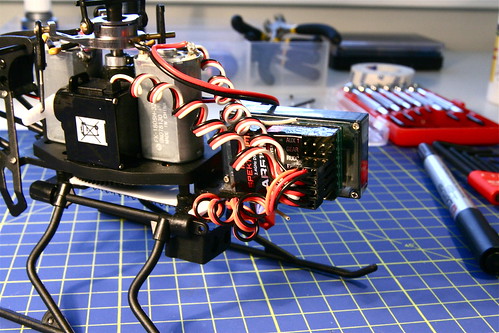

Anyone have any suggestions for setting up the DX6i for a 4 channel coax heli? It utilizes two servos and a 3 in 1 controller. I'm guessing that I would start with the 90deg. swash setting but where do I go from there? Especially of concern is if the "Proportional" can be set/adjusted on the DX6i since I can't get enough adjsutment on the 3 in 1 to tune out spinning.

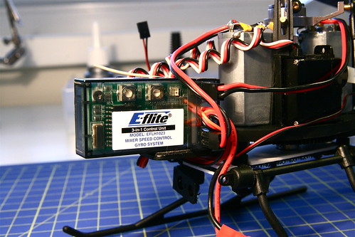

It's an E-sky E500, almost the same as thier Big Lama. I've already changed the 3 in 1 to the e-flite unit and have a Spectrum AR6115 ready to install. What started this all is the original E-Sky 3 in 1 caught fire about the time one of the granddaughters was starting to show interest and I like to get it flying again to encourage her.

I run Lama V4 with DX7. Replaced E-Sky 4in1 in E-Flite 3in1 and Spektrum AR6100 receiver. I do not know why but it works much better than original. Only have to touch trims couple of times during one battery (comparing to having to trim all the time with original 4in1). If it helps you my Radio settings are the following:
Model ACRO (note! not HELI)
Wing type: FLAPERON OFF, V-TAIL OFF ja DELTA OFF
Servo reverse ELEV (3) ON ja RUDD (4) ON
Expo ELEV and AILE +12%
