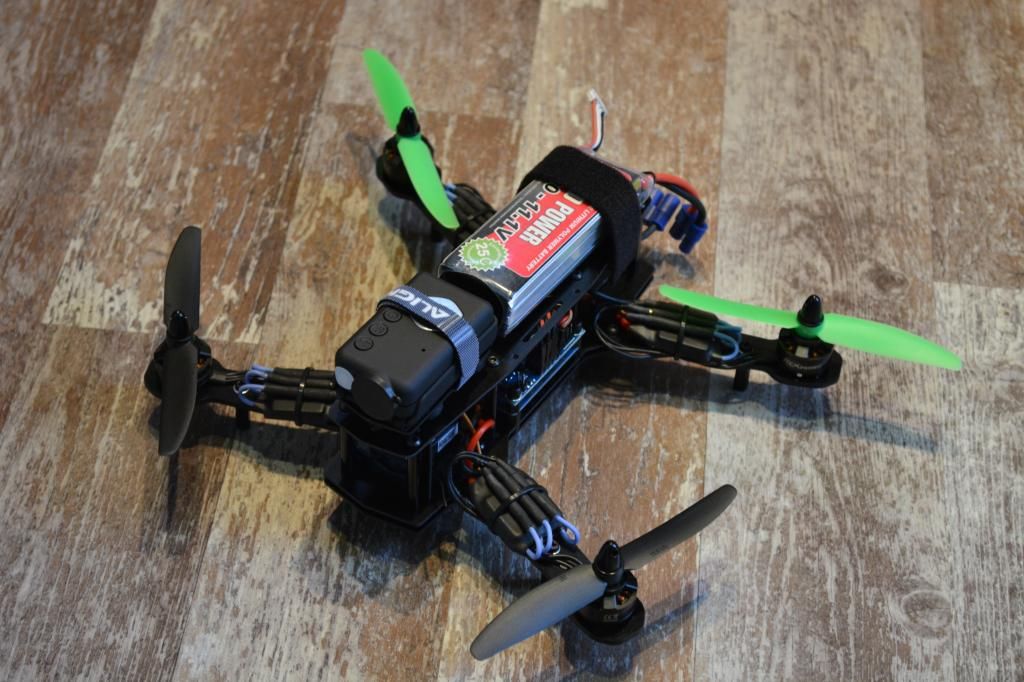

Quad 1st flight with my first build and 1st quadcopter. Always exciting !!!
DavidDutch
Always exciting to do a first flight especially in little windy condition and if you never owned or flown or build a quadcopter before, but was happy to land it again in one piece:). The setup is simple and only costed 84usd excl. camera,RX and LIPO (total build incl. camera and RX and Lipo cost is around 180USD, but already had camera, RX and lipo)
video is atm uploading, nothing special just practise :)

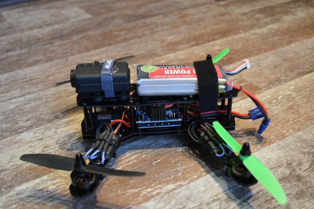

260 quadcopter frame
4x 1806 2300KV motors
FC KK2.1 LCD
ESC 12A RCX
RX601 receiver
TX Devo 12
4x 1530 props
Lipo 2200MAH 3S 25C redpower
Camera mobius
Just a standard mini Quadcopter to have some fun. I still have to do some tuning but was not unhappy with my real first flight with my 1st quadcopter.
Props are not balanced yet since I dont trust my balancer aswell. The movements are really slow so have yet to figure out where I can change them on the FC. (it is like flying with 80% exp and don't like that)
