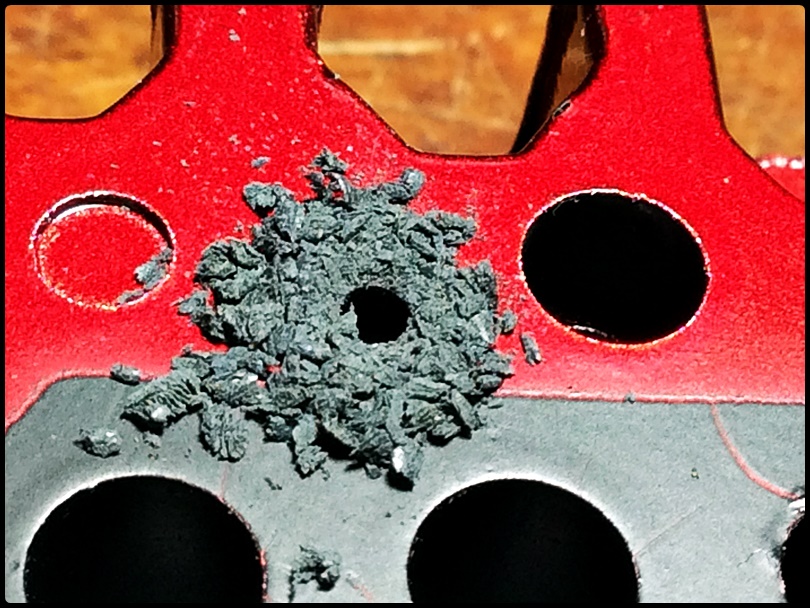

That is when I went out to the shop and I chucked up a small brand new drill bit in my drill press. This press spins a little faster than I wanted it to, but with high feed rates, I was able to get a good curled chip out of it. The rest was almost powder. But I kept going down, and nothing but black PLASTIC was coming out of it. This thing is absolutely NOT aluminum.
